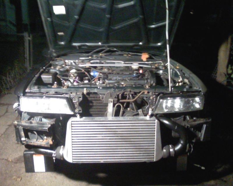

so now that the factory paint is back the car is making me fall in love more and more, im getting so excited at this point im even workin in the rain like it aint nothing, got sick as hell the day i put the FMIC and ICP back on the car..
time for the headlights and grille..
TIME FOR THE START UP!!!!!!
